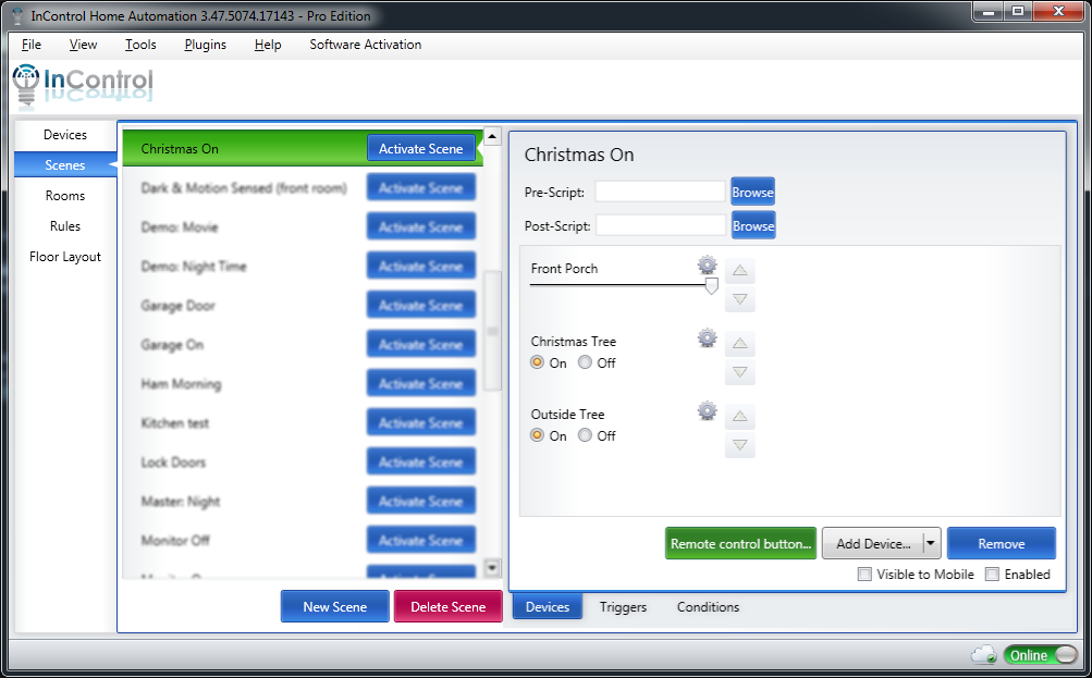

Scenes are a way for your computer to memorize which lights should be turned on and which should be turned off. We'll create two scenes, one with all your Christmas lights on, and another with all the lights off.
From within InControl, click on the Scenes tab. Click the New Scene button. Add all the appropriate modules to your scene using the Add Device and make sure the slider is at full power. Name your scene "Christmas Lights On."
Now create a 2nd scene and add the same set of modules to it. This time make sure that the slider or the button indicates they are all powered off. Name this scene "Christmas Lights Off."
